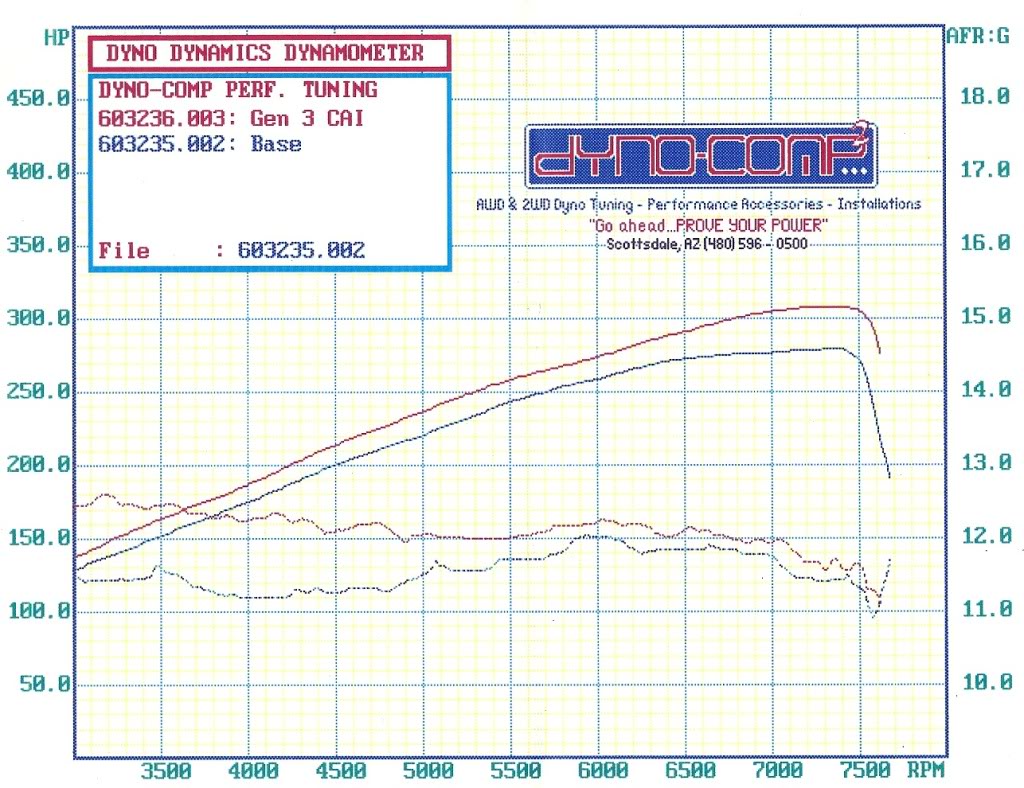

Base Dyno:
Dyno after intake + ground kit (everything else is stock):
Comparison: stock vs. intake:
Air- fuel ratio after install:

Very lean AFR above 6500.
Any detonation??

replying to some of your questions:
1- Honestly, I don't think there's much of a difference in choosing stillen vs black betty grounding kits since both kits seem to be very good at what they do. In my case, i just saved a bit on shipping since i was ordering the intakes from stillen at the same time..
2- I believe it was dyno'd at 5th gear
3- growling was most enjoyable in 3-4k rpm @ WOT.. nothing that would wake up the neighborhood though..
4- intake gave the hp's.. grounding smoothed the transition from engine to tarmac
5- I think I'm still within good limits (as far as the dyno guy said) in terms of A/F ratio..
no detonation as far as I can tell.
Update: Just did a 420 mile trip today from AZ to CA with a heavy rainstorm in CA.. All systems green so far, and the intakes seem to be handling the rain quite well. Hope it stays that way!
Please invest in a tune, you're running over 15:1 at top RPMs.
His afr is at 12.5 below 3500 and is dancing on 12 from 5500 and on. i think he's fine. a tune would just polish it up.
...still 29.6 hp from an intake is really hard to swallow. the median gains from the stillen are from 12-18 from G37s and 370s...of course it doesn't reallay matter what the number is, he has his delta and gains across the curve. i guess that's what really counts. congrats

Just a quick question: how come it says under the customer line item on the dyno, 08 G37 for the base and the 09 G35 for the intakes? Is this just a weird error entered or was the base on your 08?
Just noticed that and wondered... Awesome gains though!
