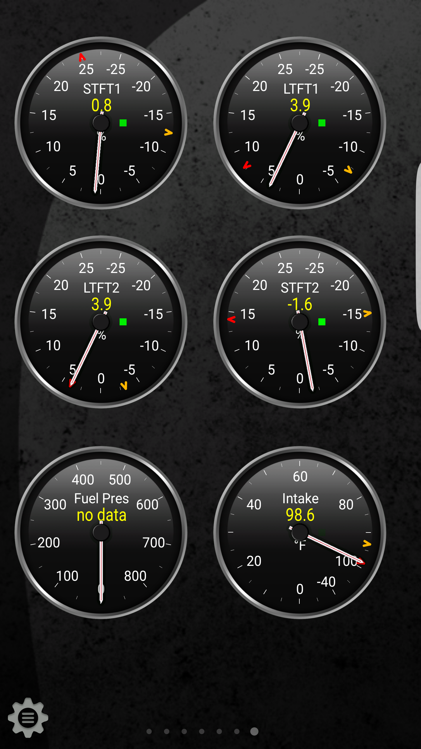

Check at your AFR while at idle and at a steady speed, does it should show 14.6 - 14.7 for both banks?
What is your air flow at idle and at 2,000 RPM (while parked)
I am starting to think your next step should be getting new/used factory cats. This might clear up all the issues.
#23
Car stays at 14.7 while at idle and damn near that cruising. It will go to high 12s floored...
