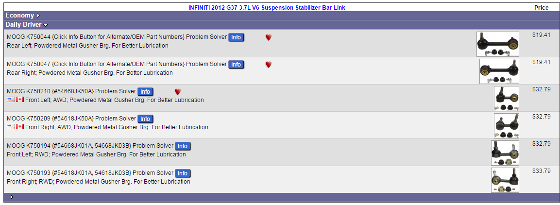

Rockauto carries them.Click here. (not sure if link works)
I used them to replace my OEM ones in the front. They're great if you don't need adjustability, and mine have been through a few trackdays as well and they're holding up great.
Awesome, I don't really care for corner balancing, I just want stronger end links for my Hotchkis sway bars and these seem like the best option.
