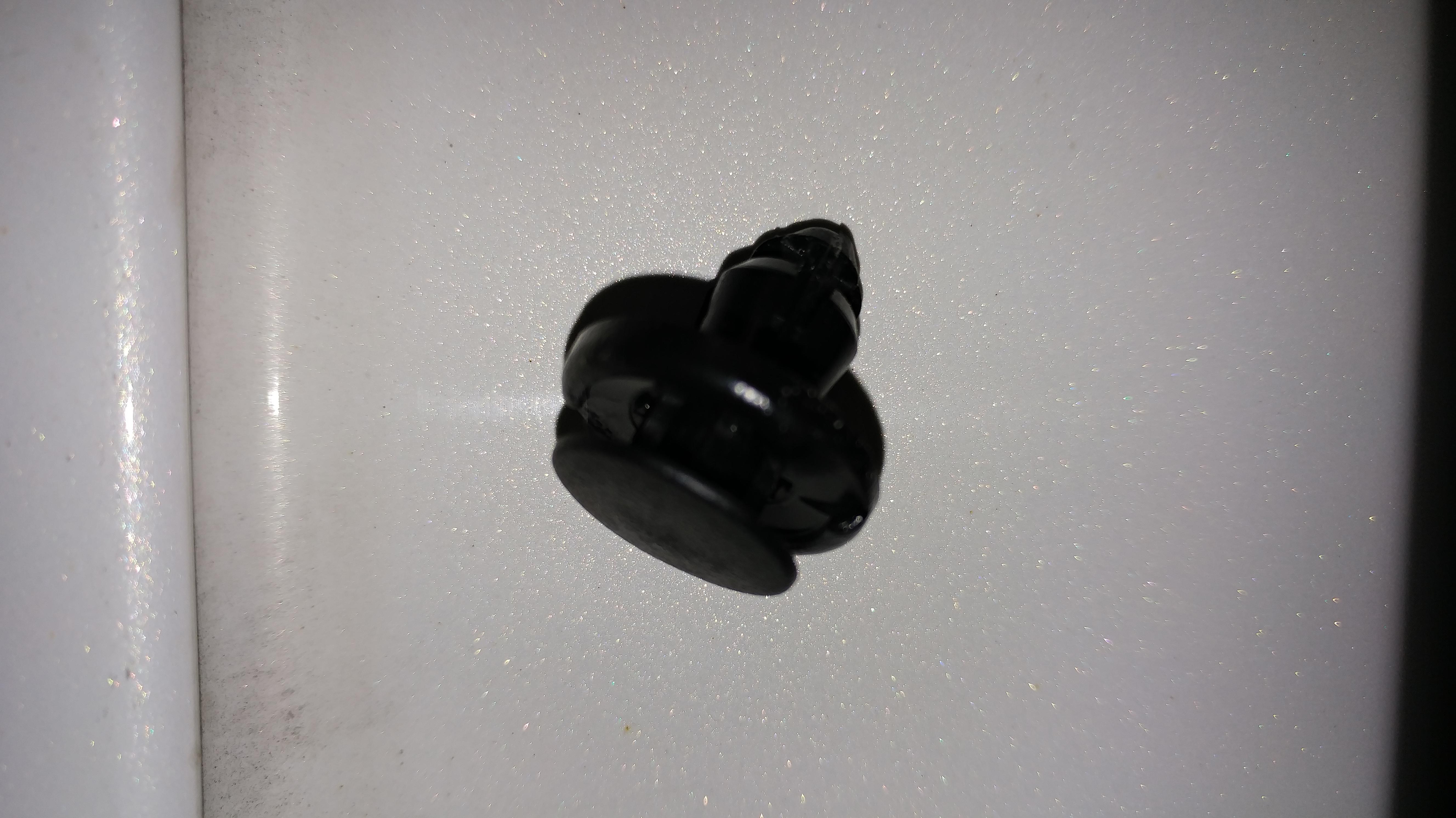

Remove the cover under the truck deck. Use the flat head screwdriver to remove the (5) "pop snap" retainers. The cover will come down but the rear is still attached with Velcro.

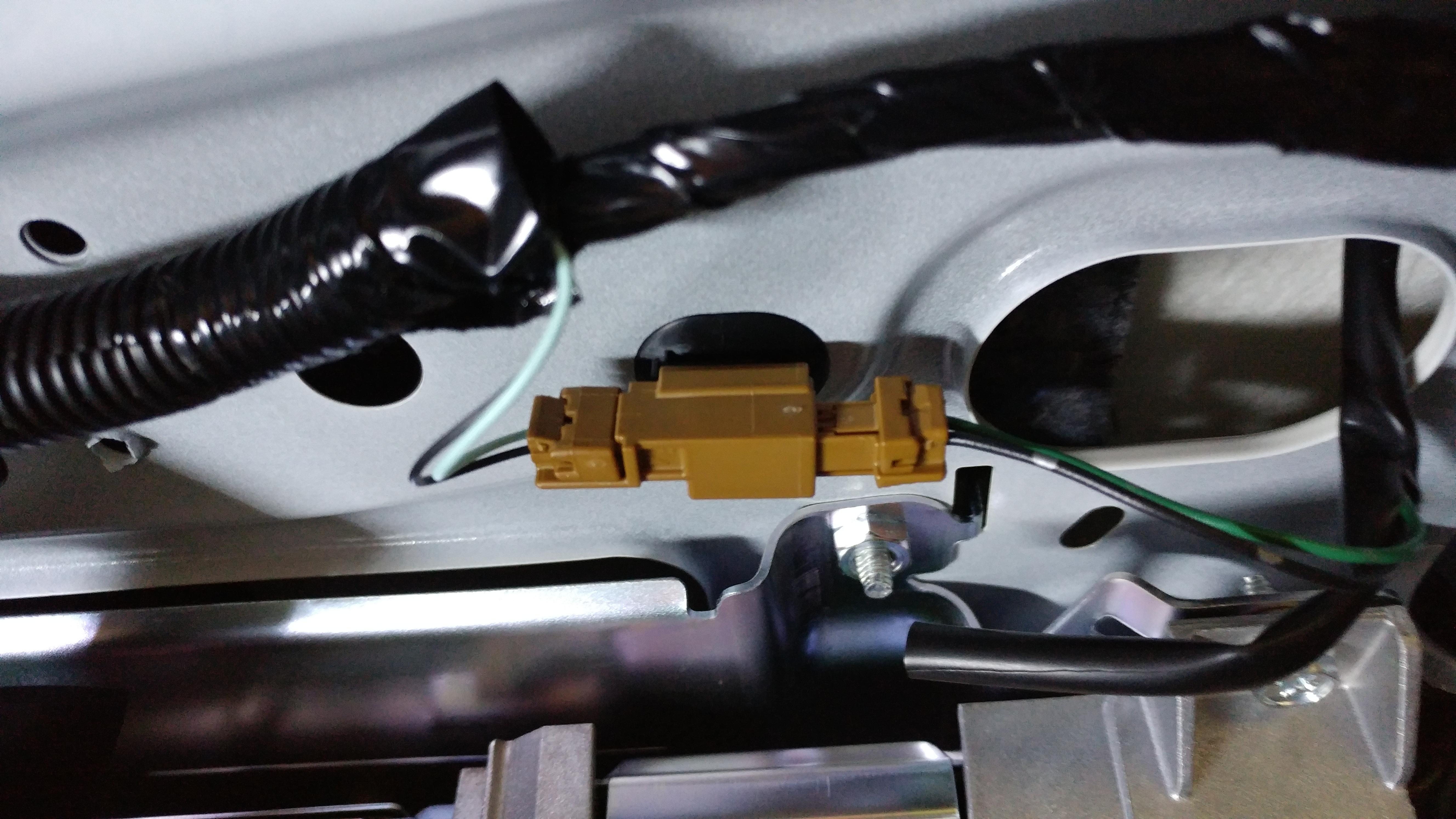

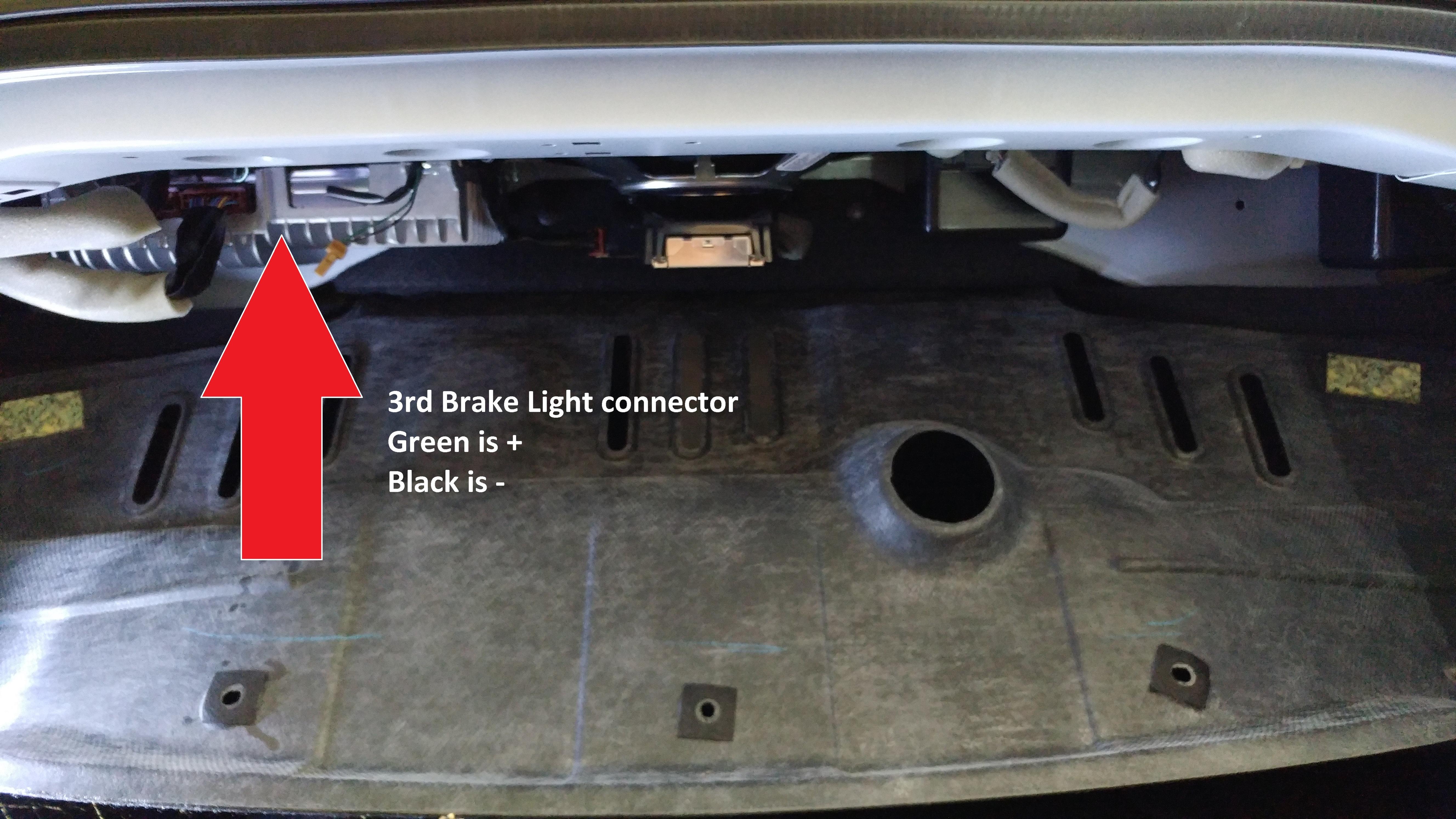

Locate the Center Mount Brake Light wiring connector. (See photos) It's a brown connector with green and black wires.
Step 3.

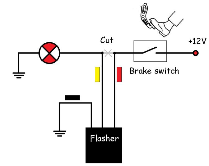

Cut back the black wire protector on the wires going to the brake light. Then cut the green + wire.
Step 4.

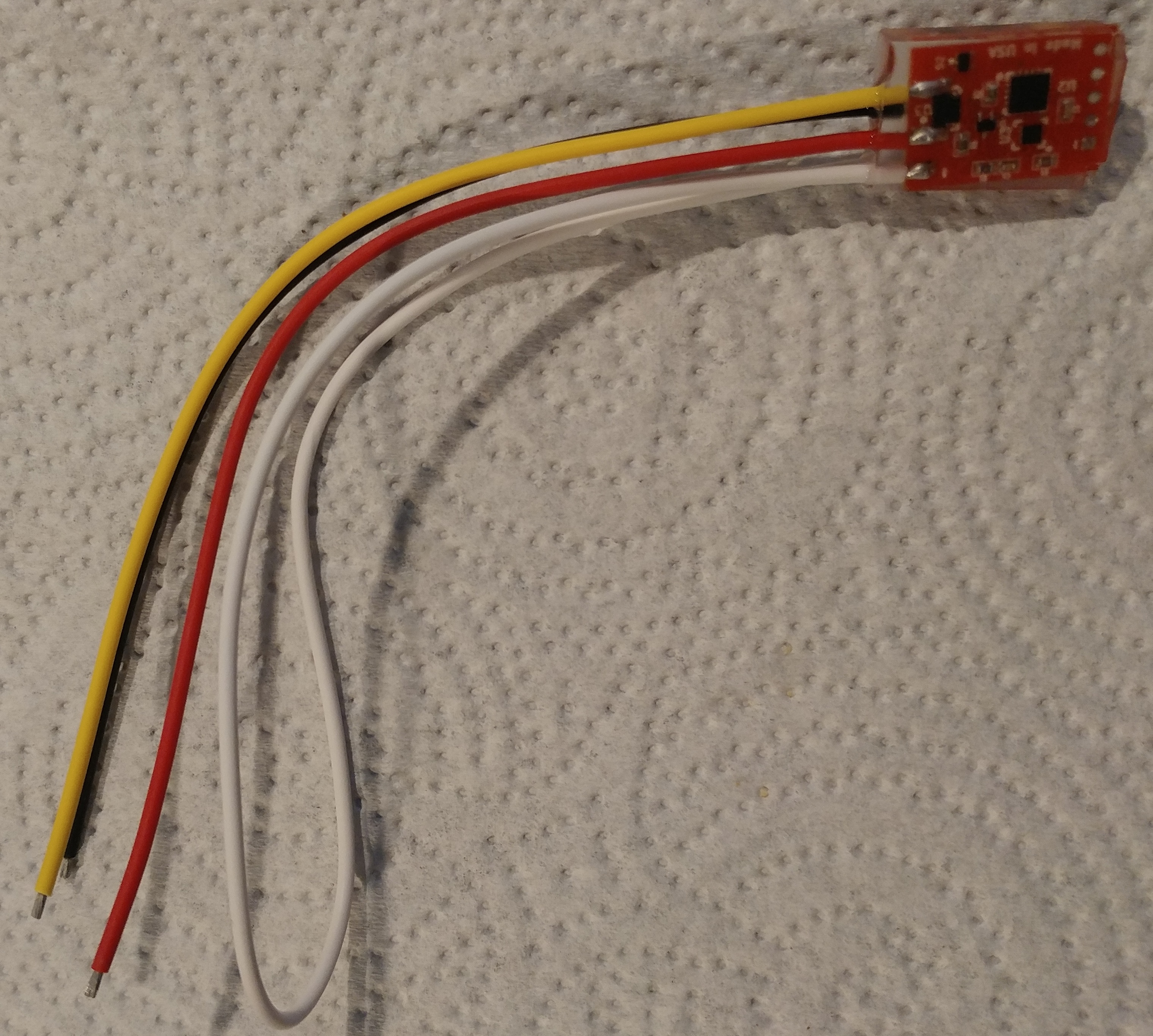

Connect the brake module wiring according to the instructions.
